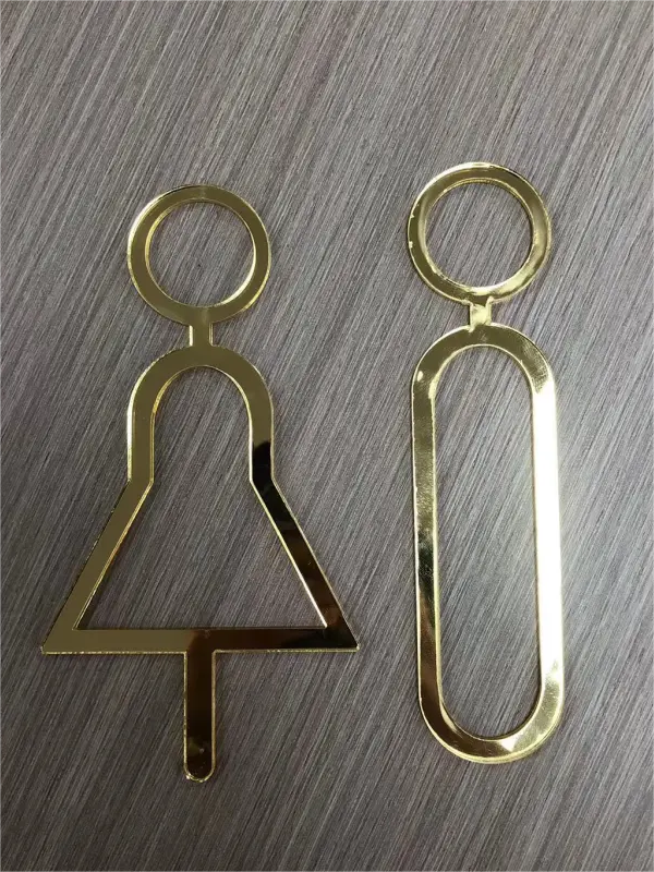

Skulptureffekt
1669084597592-41b0b3c2-44a9-41c9-90a2-2edc1c030d47.jpeg?x-oss-process=image%2Fwatermark%2Ctype_d3F5LW1pY3JvaGVp%2Csize_36%2Ctext_6Zu35a6H5r-A5YWJ6Zu35a6H5r-A5YWJ%2Ccolor_FFFFFF%2Cshadow_50%2Ct_80%2Cg_se%2Cx_10%2Cy_10
